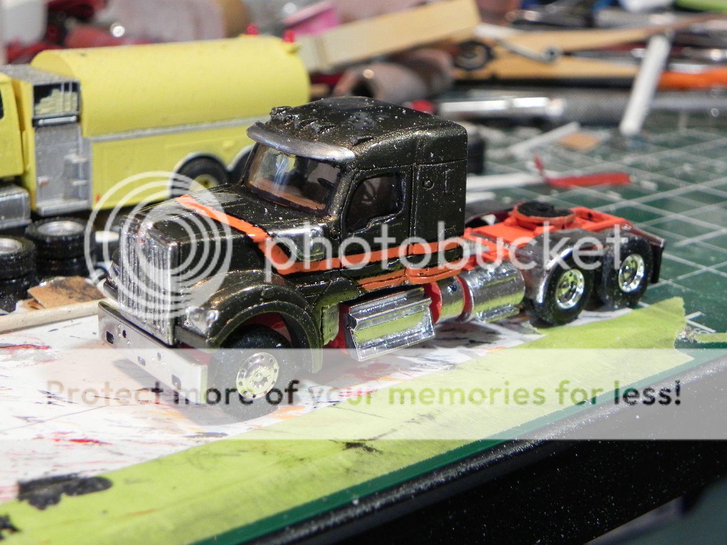

On with the project, cab slightly sanded, black stripe added
re-cleared and set up on the painted chassis for a look, battery boxes and DEF tank are supplied in kit :)
needs some tweaking yet again!
And the chrome starts......love this part! All chrome so far is Molotow Ink pen with Testors graphite for the grille it self, Dennis Aust bumper installed

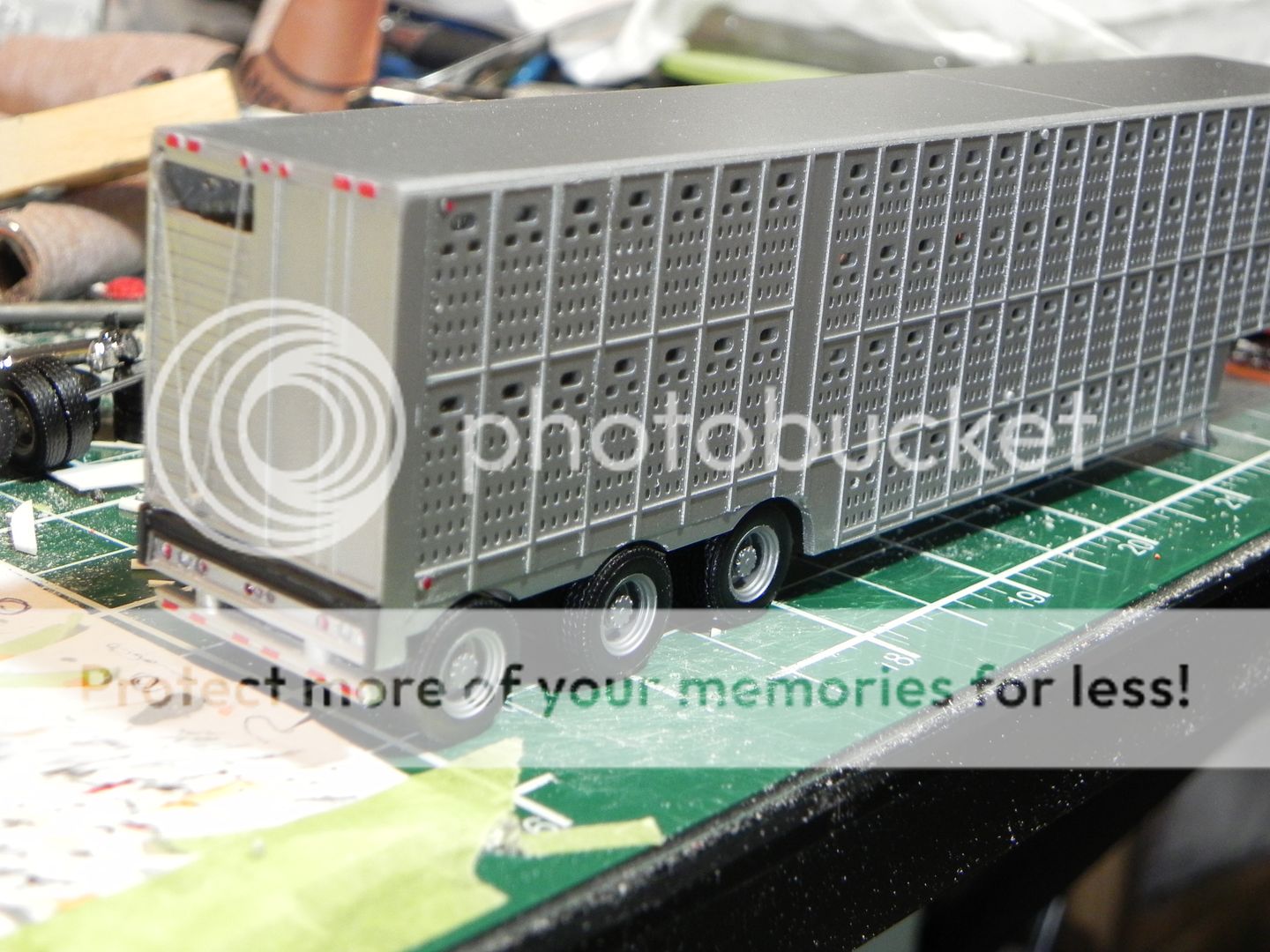

On with the trailer progress, the rear of the trailer really required some modifications IMO, I opened up the top section of the rear overhead door -as is common on most I see-  added the pull rope to open it with, added a rear bumper, moved the lights down, added clearance lights upper and lower along with the rubber bumper pieces
added a storage door to store the winter panels when not in use(?)
rounded front corners and all roof sides as seems to be prototypical on Wilson
ready to send to the paint dept for a coat of fine aluminum base toner, then clear-coated to give a non polished aluminum look
some of the detail painting begins :)

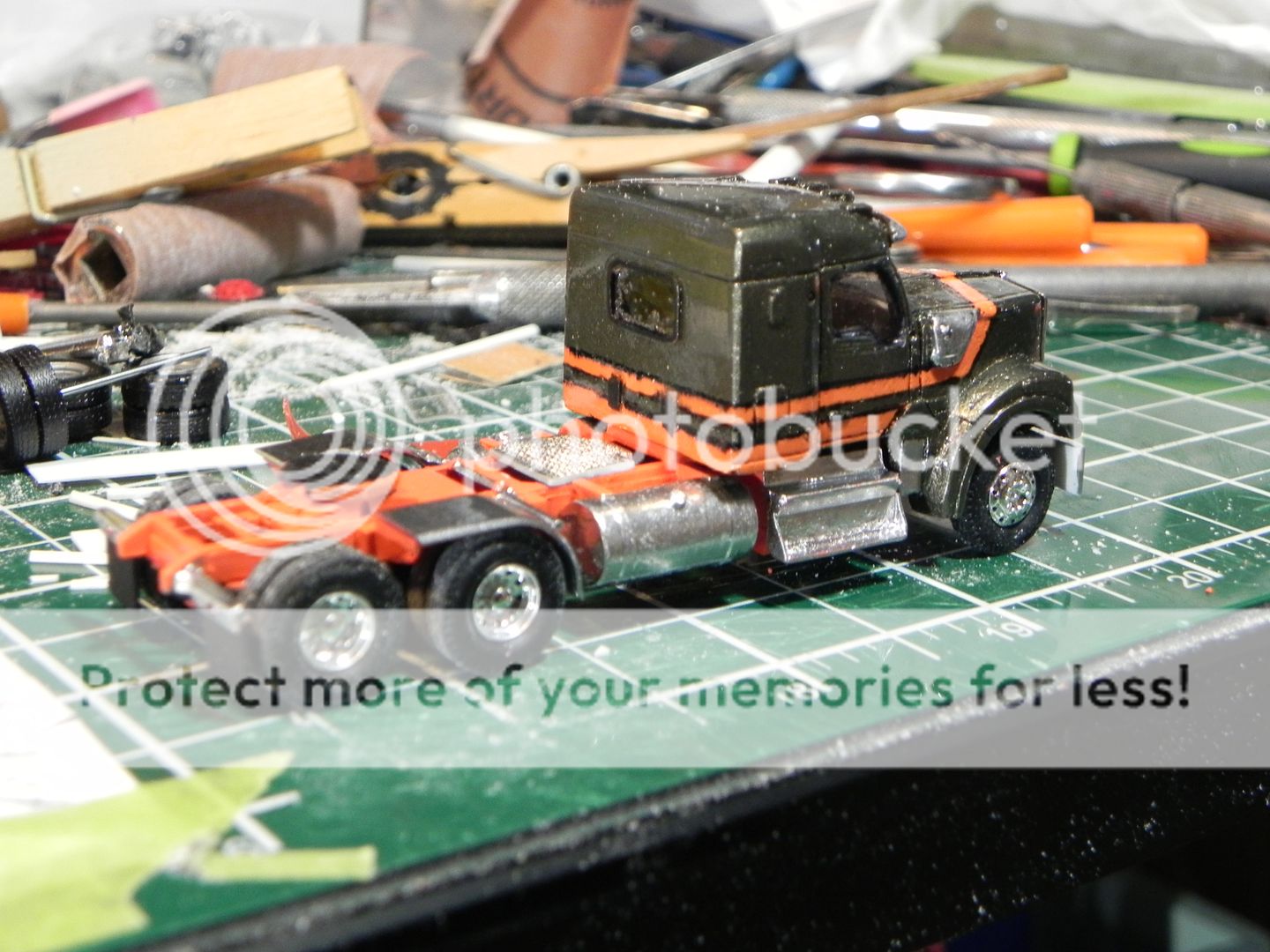

on to the power unit, half fenders added, fuel tanks are A-Line 120 gallon -except the LH tank shortened to 80 gal.- chromed with Molotow Ink Pen, windshield fit in from a blister pack and side glass flush-mounted with gasket detail using a Sharpie pen,
the rear window is Humbrol Clearfix and the interior is in, all wheels and tires are from Athearn/A-Line and installed
a few more details to go yet, later.

here the tractor is pretty much finished, kit mirrors added, the stacks are aluminum tube with curved tips and Model Power KW T600 muffler heat shields modified to fit, Ratclifffe air horns.
the whole unit, A-Line safety stripes added

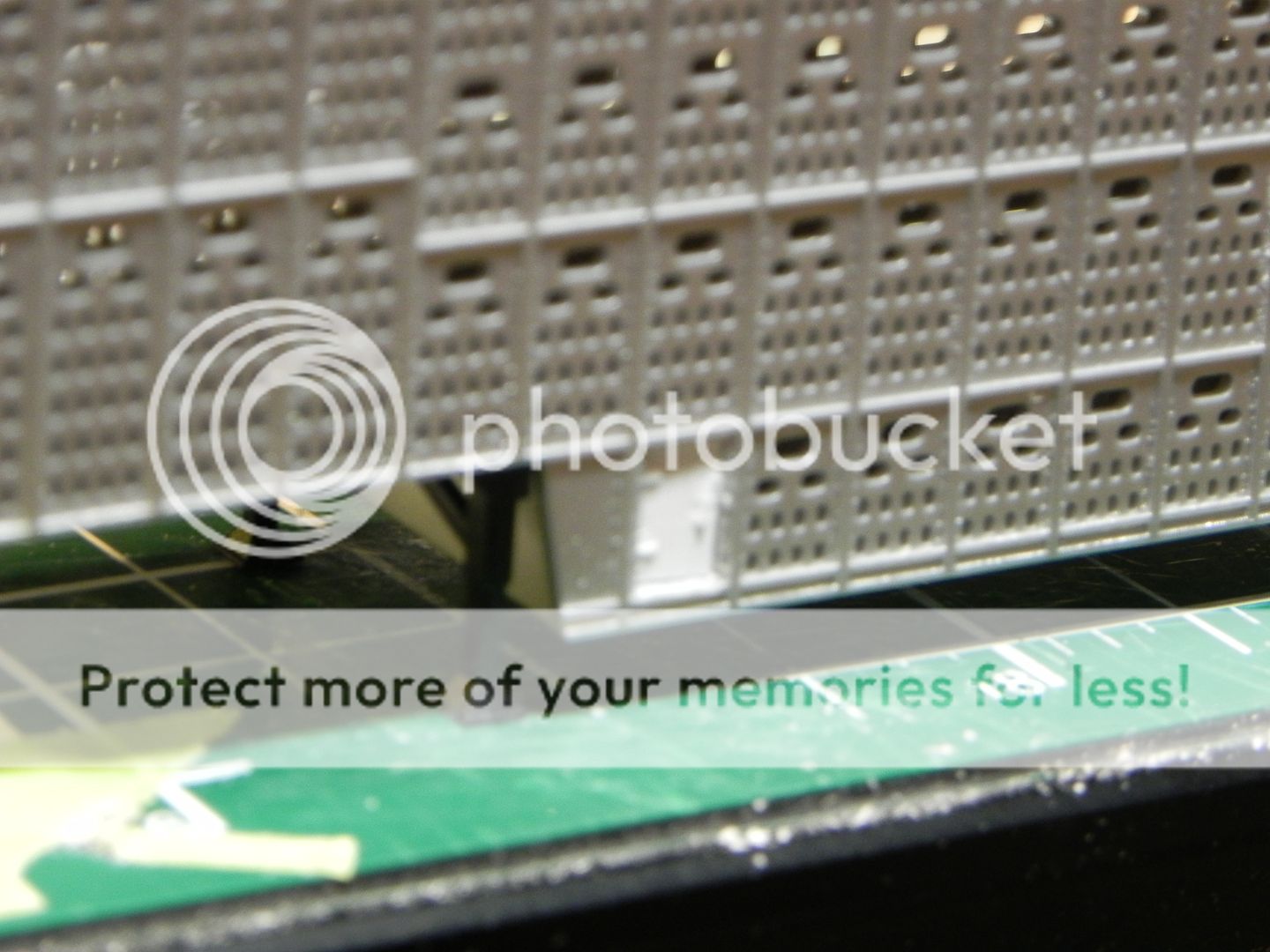

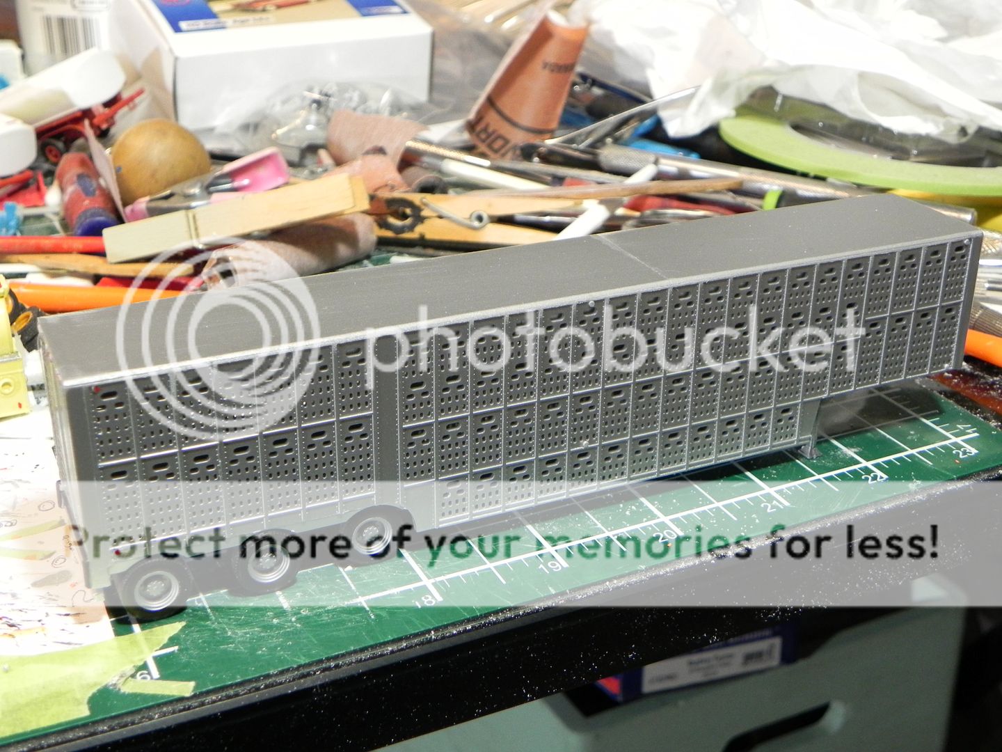

Ok, I really know NOTHING about livestock hauling or caring for the animals while in transit, so I googled it and have come up with the fact that Hogs love warmth and require winter panels when temps get cold but cattle are large animals that give off heat so they will be fine without!! Now, I didn't want to put an entire winter panel kit on as it would take away from the detail punch side, so, looking at Steve Goddard's photos I see he has several cases where just a few panels have been added, is that because it isn't too cold?? Who knows, but I like the look so this is what I have come up with.
wow, if your cut is off just by 1/64th of an inch it shows up HUGE on these pictures.......a lot of work to get this, don't think I will correct that!
maybe I will add one more row of panels to the centre of the drop section??
NOTE: My Google search also gave me some insight as to what the panels are, and they are a poly/plastic sheeting that obviously can be found in a variety of colours, they are light weight and can be locked in with these cool metal wire retainers clips so that they can be easily removed if needed.
