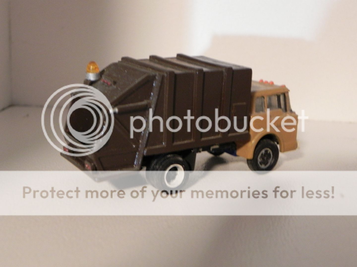

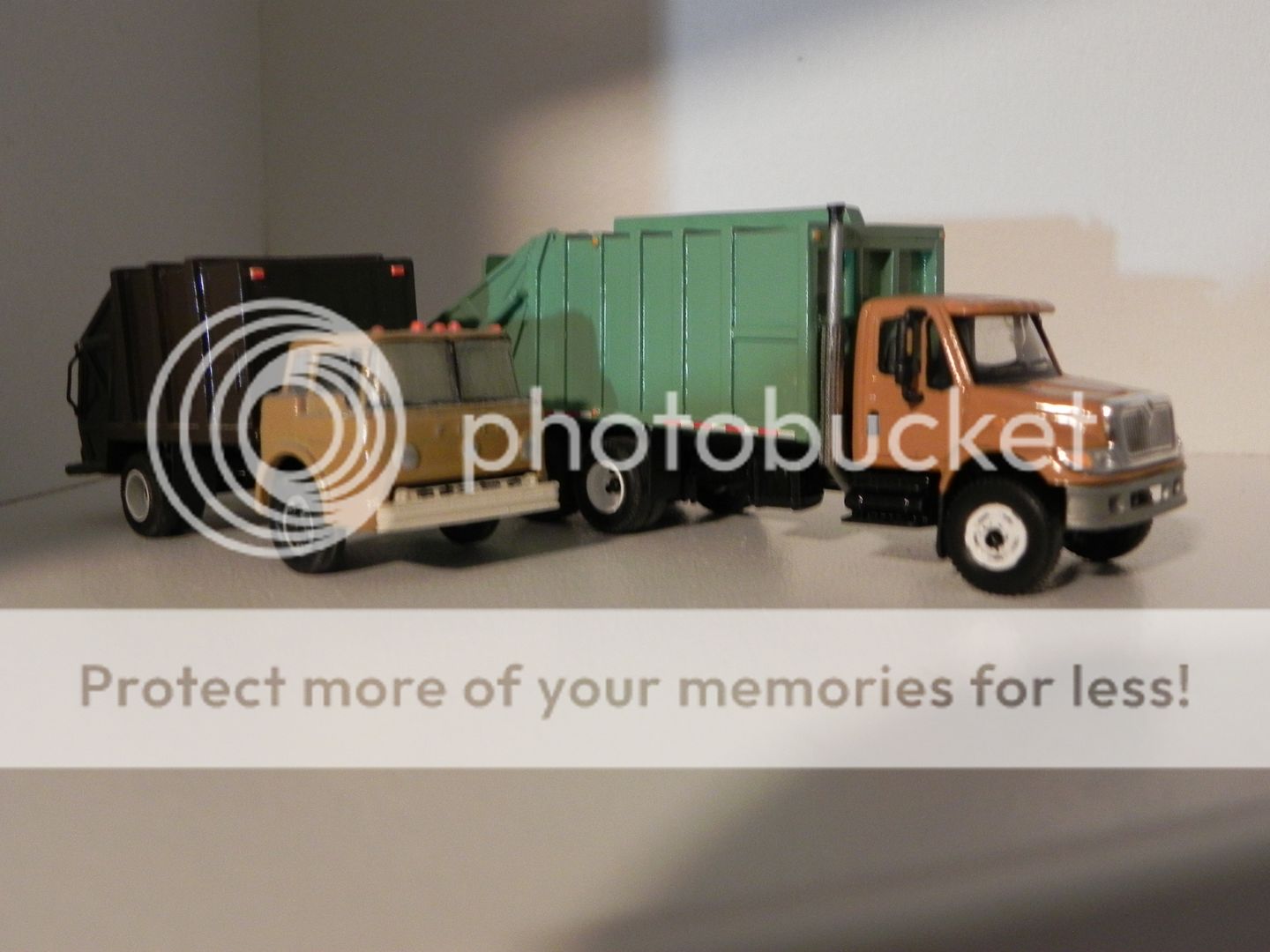

Here is the reason for the upgrade! The old Ford C cab has run it's course!

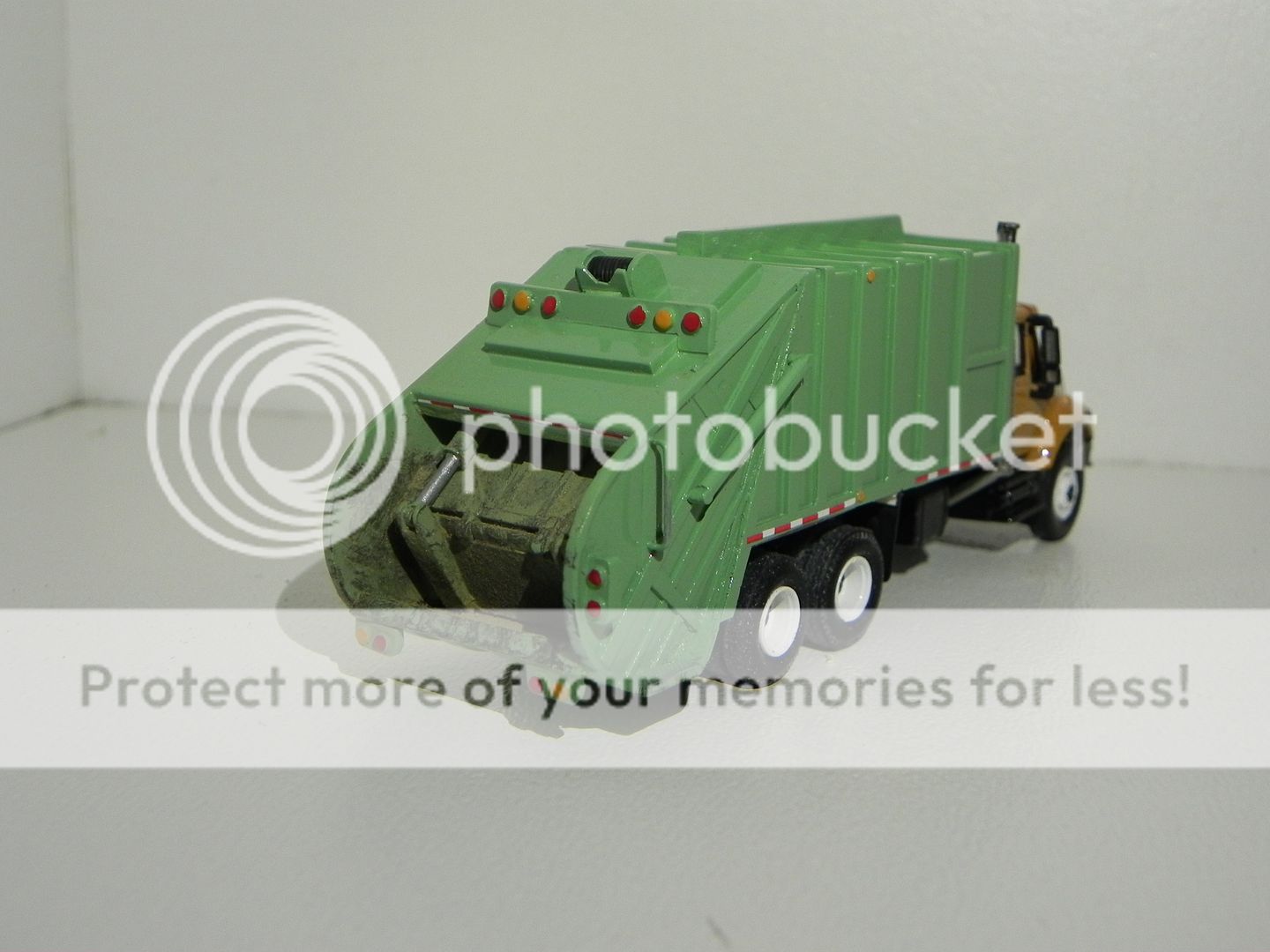

and here is the replacement ready for duty!

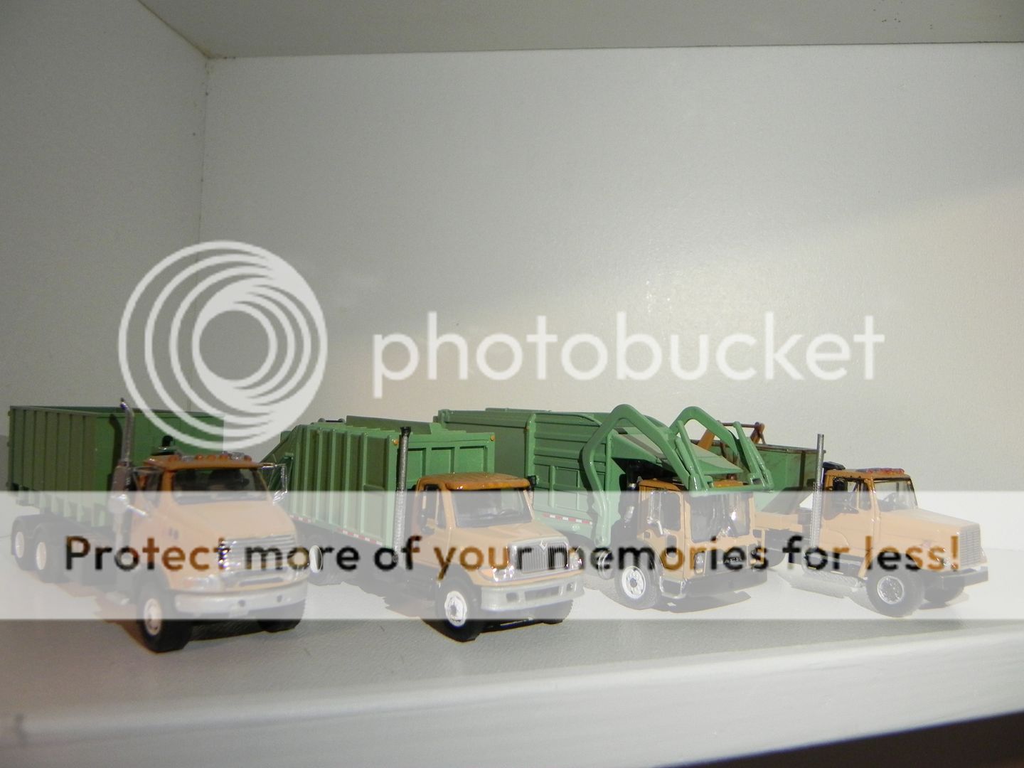

and just to answer your quest Kurt, here is the fleet, I think they can handle all the disposal needs of the region.
Now, onto big trucks again.
