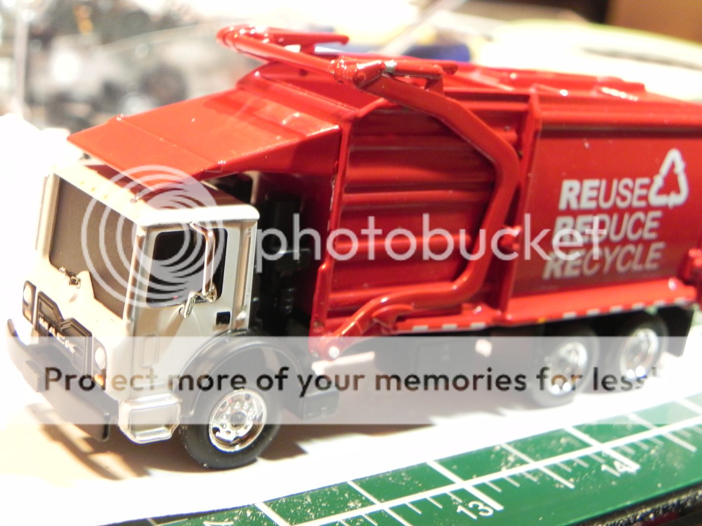

If you're gonna take these apart, be ready for a panstaking 2 hrs!! Good grief, why they have to unload a tube of ZAP to those "black" windows ALONG with the rivets, then pins on grille mushroomed over but that isn't enough.....ZAP that in too ....and all the other parts but.....it is dismantled
Not going to dismantle the chassis as some detail painting in place will likely suffice for that
and here the cab and main body stripped to bare metal, detailing is crisp so a nice "tight" re-paint should be one to showcase it all
The cab gaurd and tailgate are stripped too, they are now glued back into place, that will be in the next photo batch

assembled, ready to go to the paint shop
out of the paint shop mocked up
the other side
detailing begins along with some assembly. I found some Herpa wide tires to put up front

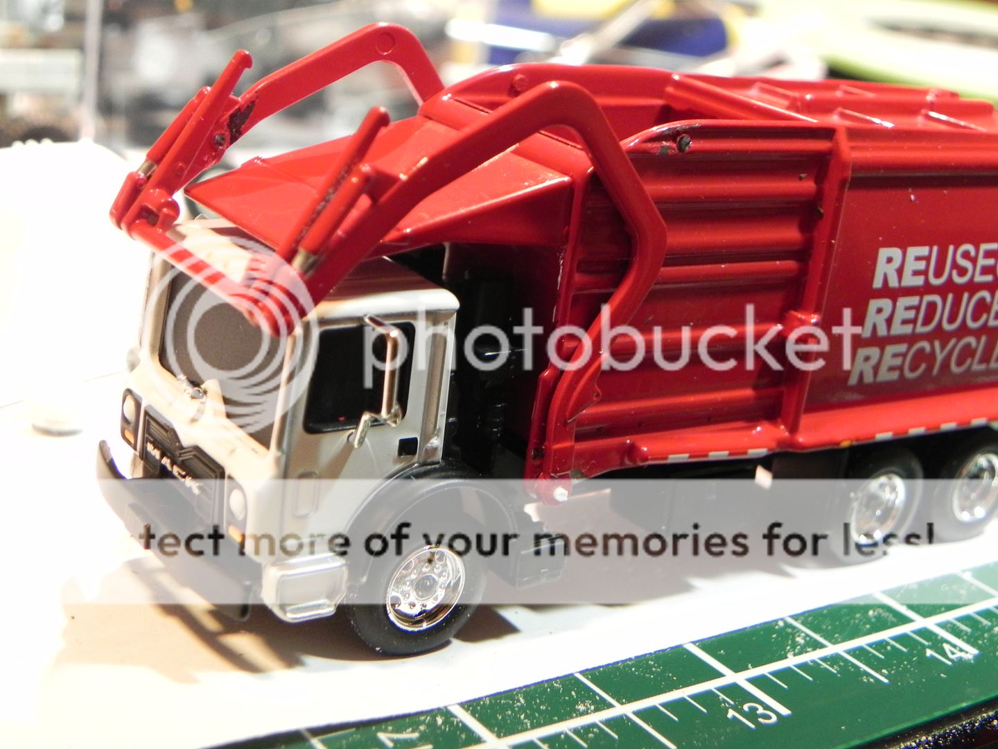

Moving along with the project and speaking of somewhat functional, this is as good as it gets for loading up the bin
now the windows, that really makes the difference between a toy and a model IMO
first adding the windshield divisional bar and the side sliding window dividers, windshield is flush mounted and side glass is from inside, all acetate from blister packs
the bulldog re-installed and a fire extinguisher from Boley along with A-Line safety stripes applied
Now for the unique wipers, thought I had some A-Line dual arm wipers or even a Classic Metal Works from the GMC Greyhound bus, can't fine them -after the move, I have not yet found everything back-  so back to the bench we go ::)

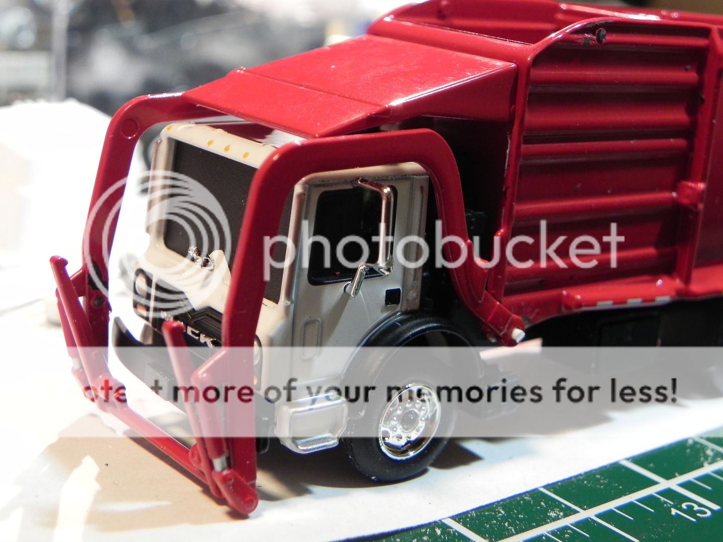

« Reply #9 on: November 15, 2018, 10:34:37 PM »
The wipers are scratch-built from staple and sheet plastic cut to strips and installed
a view from the other side.
