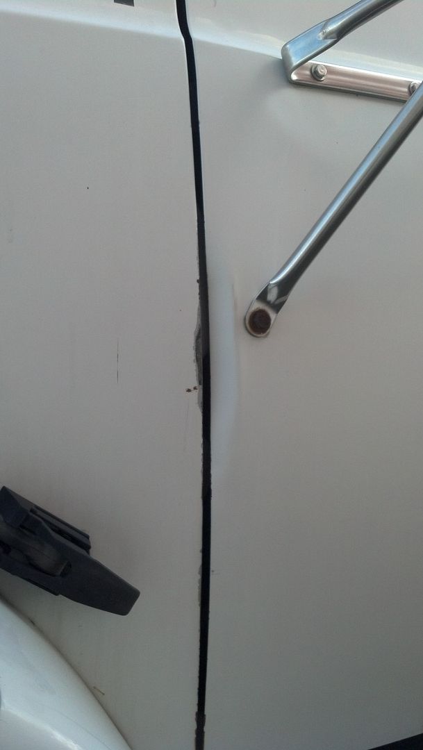

Today I was down working on it, got the door adjusted so it no longer rubs on the body. Clutch adjusted, got the bent and mangled frame walk taken off, also the quarter fender brackets and one badly bent up quarter fender off (it only had the left side). Will get down tomorrow and do more work on it, thank goodness I'm getting plenty of help from Circle T, the vendor that services YRC Freight's equipment.
This is pretty typical damage on the Brigadiers. The wind catches the door, it flies open and out of the hand of the driver. It flexes the door, causing it to eventually catch on the body. This is just about the only body work that will need to be done on the unit:

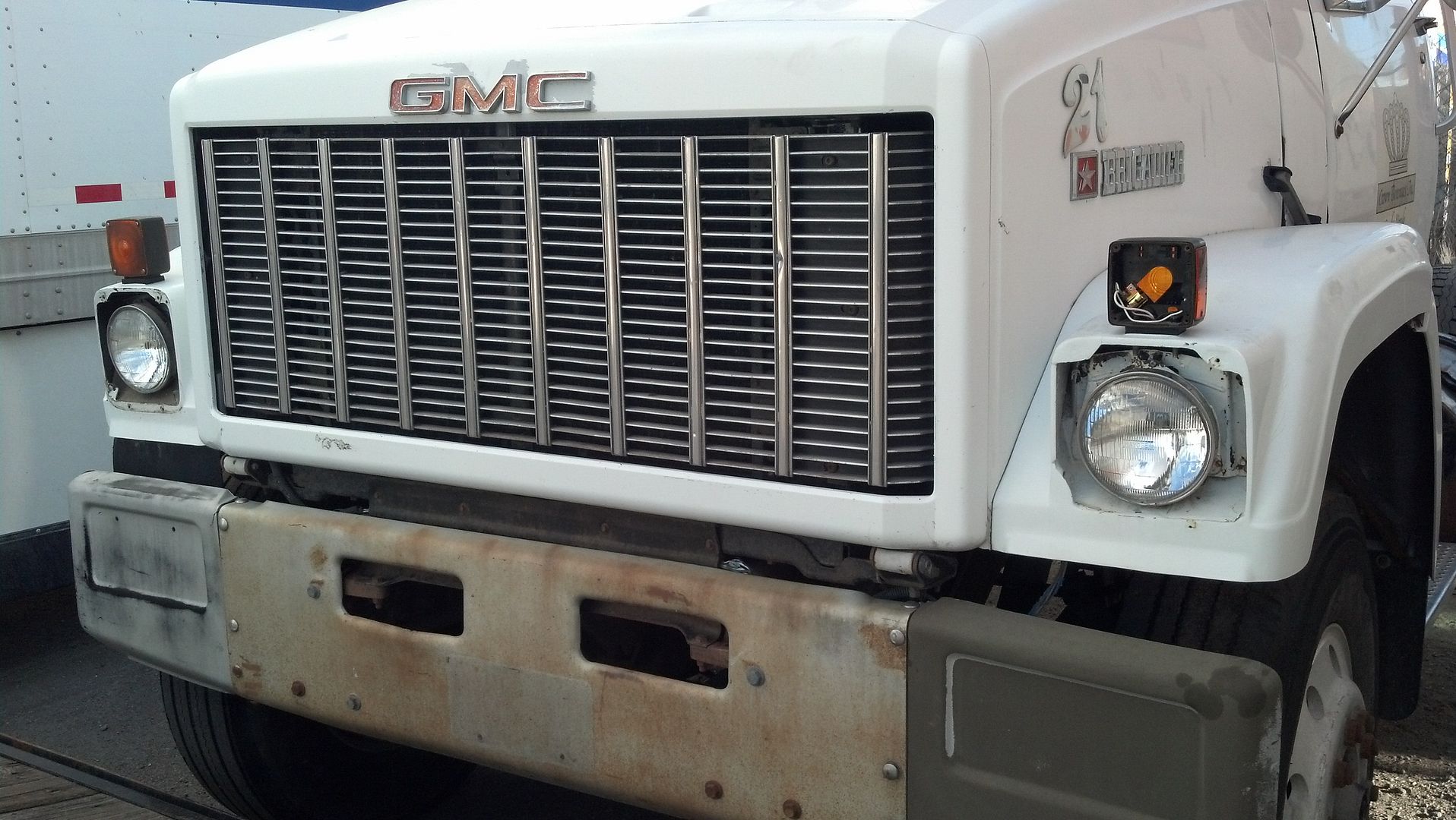

The front turn signals don't match, one is the old style with a 1157 bulb in it (Right side). The other has a bulb for both running/parking lights and another bulb for the turn signal (left side). On that one, the bulb is for the turn signal only lights on the side. Don't like that. Want the same as is on the right side. Also, want red lenses facing back on the turn signals as was the law at the time the unit was built, I think.
